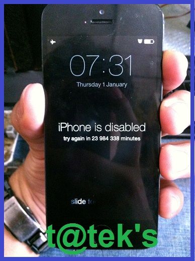

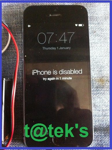

    SUBJECT:
    Iphone 5S displaying try again in 23 984 338 minutes

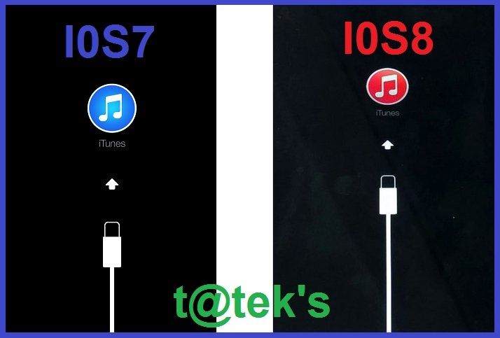

    How to check if Iphone 5S is I0S 8.xx:
    Set Iphone 5S to recovery Mode, How:
    turn off, press home then insert usb until recovery image appear on screen
    If I0S 8.xx proceed to procedure

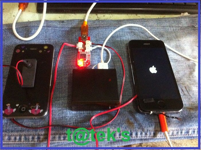

    ACTION TAKEN:

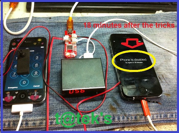

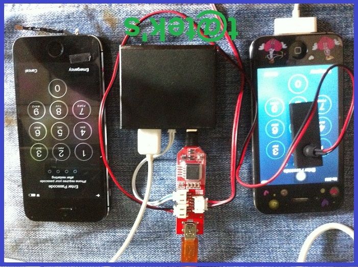

    1. connect all the connection of IPBOX and the adaptor in Iphone 5S with displaying try again in 23 984 338 minutes except IPBOX sensor
    2. Set sensor to Iphone 4 version 7.1.2 screen ( syempre lagyan ng konting double sided tape para di gumalaw)

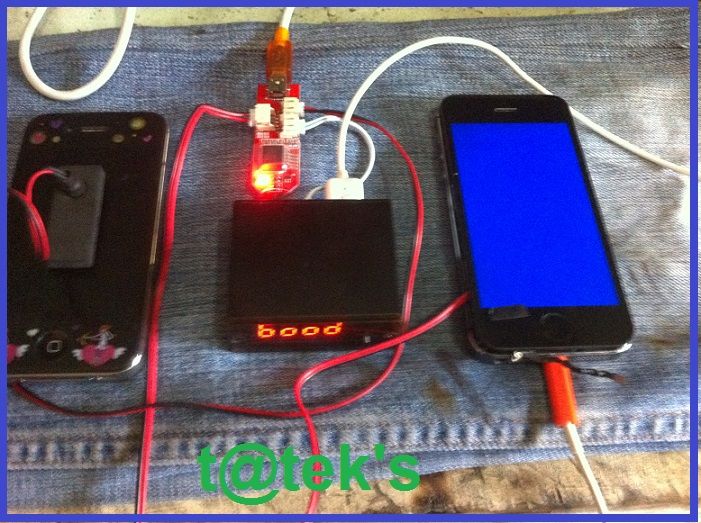

    3. While IPBOX displaying GOOD in display panel click the IPBOX button and wait for IPBOX generation to find code...
    4. Upon code generation your IPBOX will beep for error and blinking display depende kung saan siya hihinto
    5 . remove usb cable in yor Iphone 5S displaying try again in 23 984 338 minutes and connect again
    6. After a few seconds Iphone will reboot to blue screen and rebooted again to apple logo and wait for normal screen ( this is the sign that the tricks apply to the Iphone 5S ) or else just do the procedure again to take effect

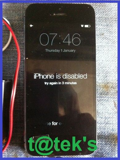

    7. Now Iphone 5S will display minimal minutes to wait, in my case are 18 minutes to wait after the procedure

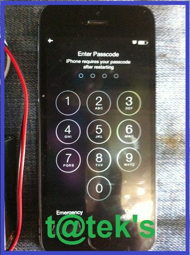

    8. Wait until Enter passcode will display in Iphone 5S
    DONE
    Kung alam mo ang passcode, pwede mo na i input yung pass code or read the code with iphone tools device that support I0S8.xx version
