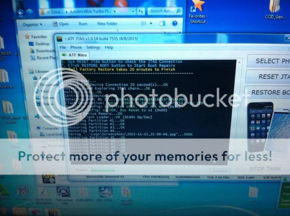

    problem : blackout unit by sir blaze25(orig thread= http://www.gsmworldfive.com/forum/sh...=starmobile+v3 )
    solution : jtag by ATF
    tools :
    * atf box jtag activated
    * usb cable
    * uart old cable (pwede yung sa mga nokia)
    procedure :
    * download first firmware here
    http://atfsupport.com/?dir=file-supp...%20AFP%20Files

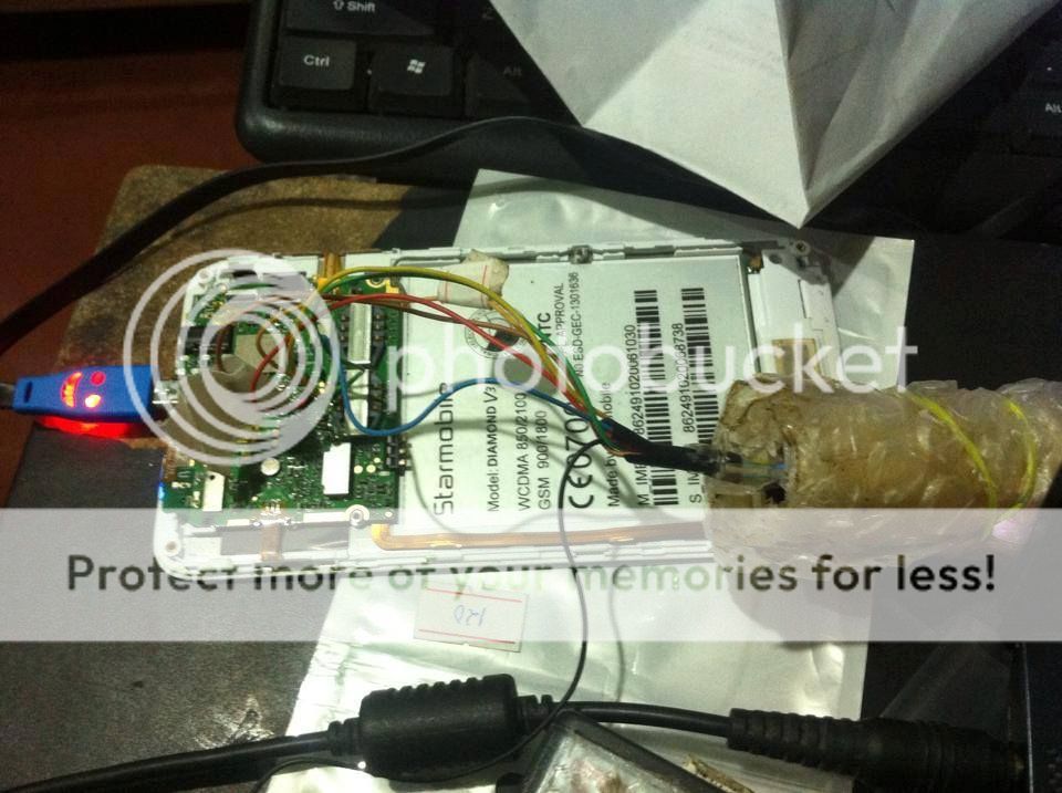

    * dismantle phone,remove all connected parts like lcd and ts (para madetect ng maayos ang qualcom ic)
    * load firmware na dinownload nyo para makita pinout ng phone
    * dahil uart cable gamit ko ,number coding ginamit ko sa pag solder at pagsunod sa pinout..(wag nyo sundin ang color coding for sure di madedetect ang phone)
    * after soldering pinout connect uart cable tapos saksak nyo usb cable yun magiging supply nya ,no need battery

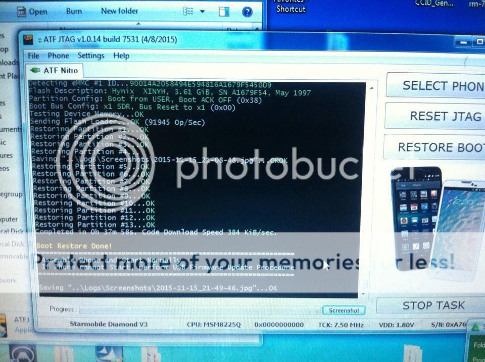

    * kulitin nyo lang minsan may error
    * hintayin matapos flashing
    flashing :
