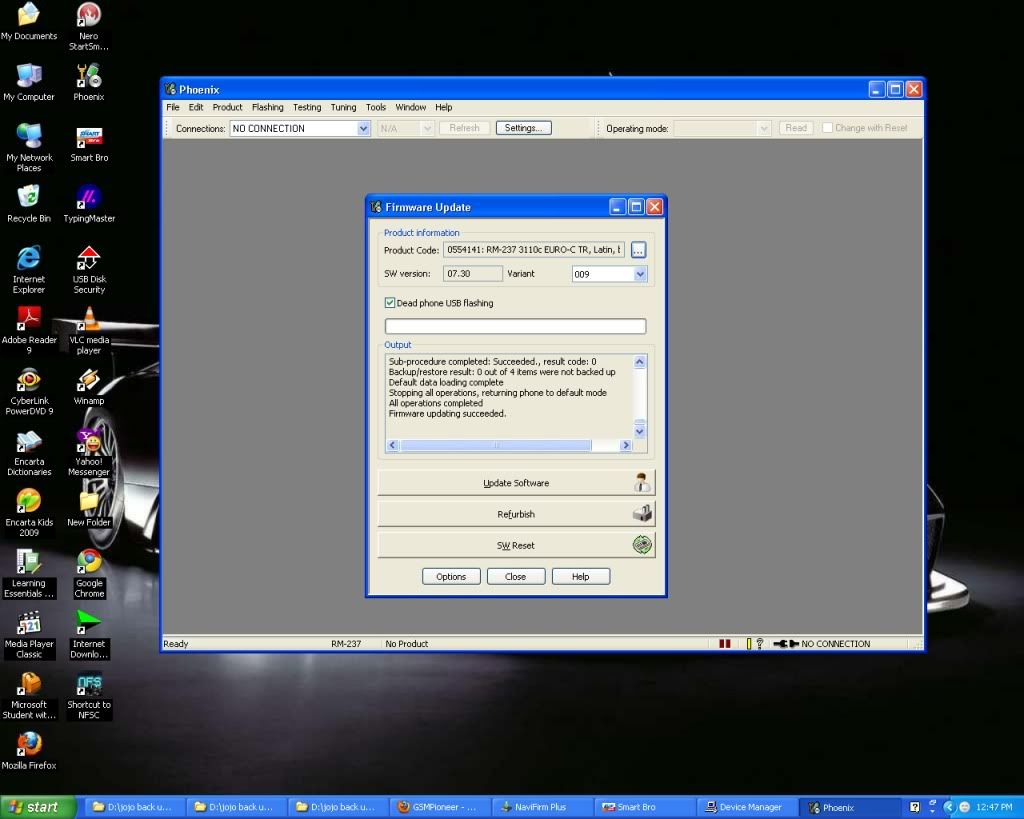

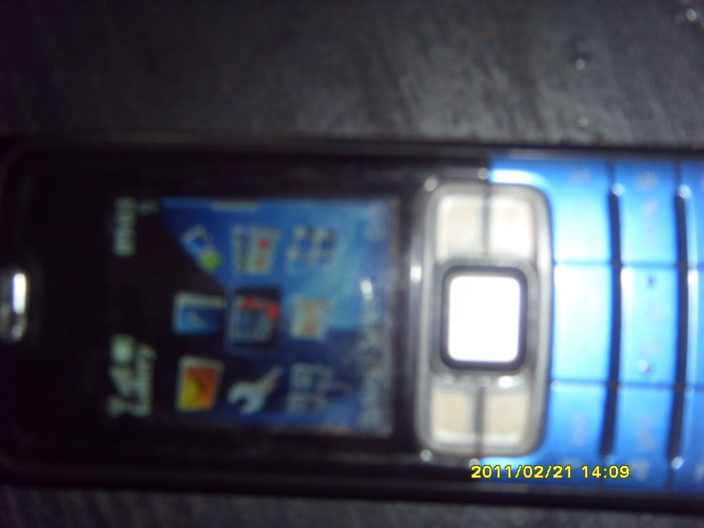

    ModelUnit:3110c
    Problem:auto off
    Action taken: Program using Phoenix crack
    Tools/ Phoenix crack,USB Cable
    procedure:open phoinex crack
    open file/click open product
    open tool/click data pakage download

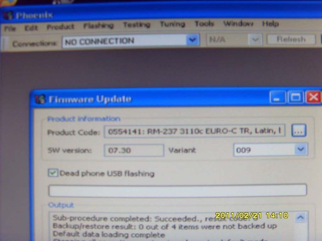

    type the 7 digit code of your phone
    click check aviality wait until download is finished then close
    open flashing/click firmware update
    select product code/click refurbish.....done
    logs:

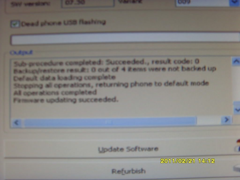

    Backup/restore result: 0 out of 4 items were not backed up
    Default data loading complete
    Stopping all operations, returning phone to default mode
    All operations completed
    Firmware updating succeeded
    finish product:
